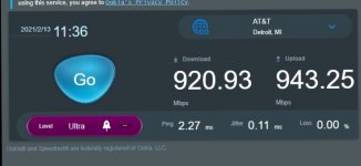

Wanted to add. The speed test on the AX58U works very well.
