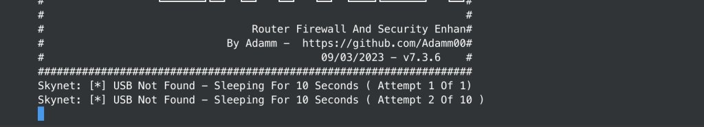

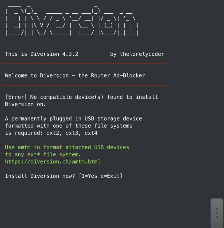

Seems like Diversion is broken in the beta. Can’t install it for some reason, my entware works fine. Noticed on the alpha it made me reinstall diversion now it just won’t install.
Edit:
Wait maybe my usb isn’t working.. why hm.
Edit 2: aaand it’s back working after a reboot. Odd will watch if it goes down again.
