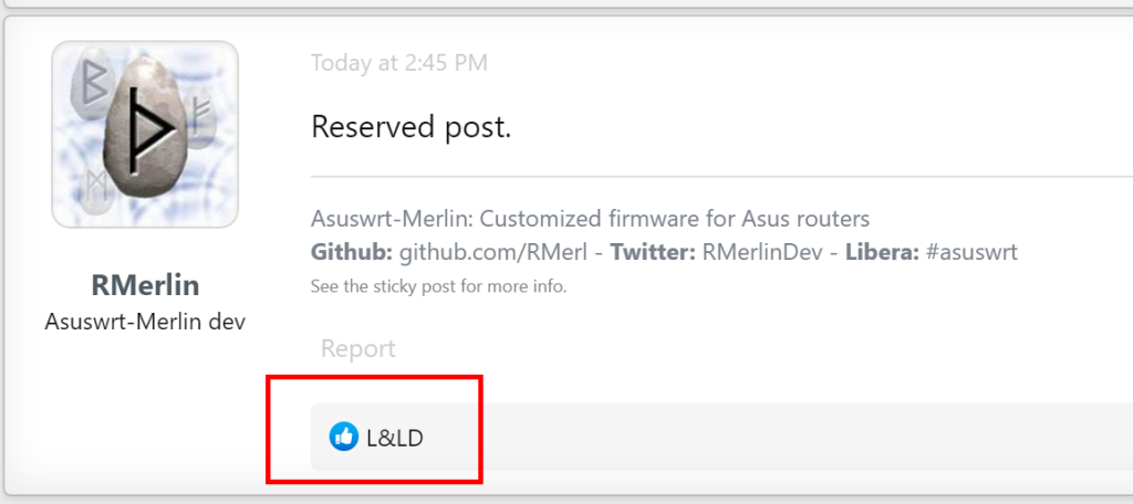

EDIT: Initial filthy upgrade from Alpha 2 on all APs done here. No issues to report, as expected. Will recycle the APs again in 15 mins and then let settle.
And... @L&LD ... you on a LIKE mission? LOL!
