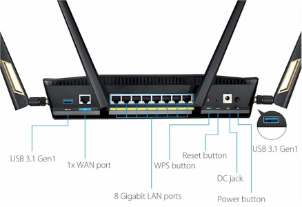

Hi all! Does anyone know (may be @RMerlin himself) how the new hardware revision of RT-AX88U_Pro differs from the previous one? Thank you in advance
AX88U
1.8 GHz quad-core CPU (BCM4908)
1x USB 3.0
1x USB 2.0
8x ports Gigabit
AX88U Pro
2.0 GHz quad-core CPU (BRCM4912)
1 x USB 3.0
2x ports 2.5G
