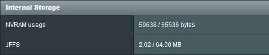

very high NVRAM usage in asus rt-ac3200? flashed 380.60 beta2 over stock firmware...do the factory reset and all settings step by step manualy....is this normal for ac 3200?
