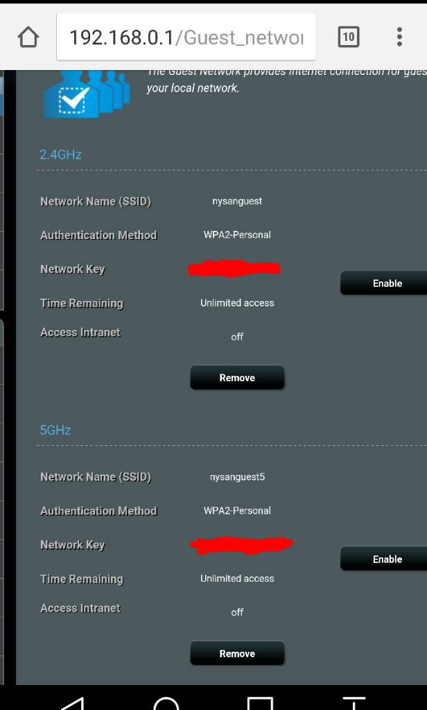

@fax, I have tried everything with the guest network and it's only with the 5ghz guest network this problem exists. If I test with the same setup on 2,4 it works as it should. I know that it not good practice to use the same password for both guest and standard network but I have it this way to stop the kids ipad from being able to cast to chromecast and airplay.
So the bug only exists on the 5ghz band. Try to reproduce it with the same password as the standard and see if you get the same outcome.
Done, 5ghz Guest, same password of the main connection. Can't replicate what you report.

I can edit move create without problem an I can cast to chromecast on the standard non guest network and it only happens on 5ghz guest net and not on the 2.4 guest network.
The only non standard setting I use is stp disabled but this shouldnt interfere.
If no one else can reproduce this bug I don't know what other info I can give you.
