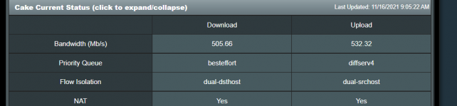

I think any quad core Asus router should be able to handle 500mbps+ cakeQOS. Anymore than that, switch over to Flex. At less we have option to maximize output from ISP.
The number of cores is not relevant as cake is single threaded. None will get close to 500Mbps.
Core type and MHz is what counts.
