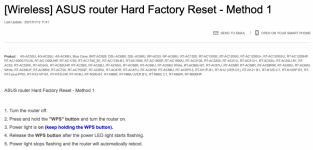

I was able to resolve the issue. I hope this helps since I went through the same problem of not being able to login into the GUI of an Asus RT-AC68U. This was the first time it happened to me and I have been upgrading the firmware on this router for years with no issues.
The recommendation is to Reset the router (hopefully, you took screenshots of all your settings as well as saving your Settings in the Administration section), but I thought it was a simple press the Reset button in and hold it. That didn't work for me, so I looked it up on the web and Asus says in order to do a hard reset:
Turn off the router, hold the WPS button in, turn router back on (keep holding WPS button), and release the WPS button after the power LED stops flashing. This worked for me. I'm able to get back to the GUI with no issue now and I'm on the current RT-AC68U_386.1_0.zip firmware.

@DCswitch welcome to the forums.
Good first post, reinforcing the WPS method works wonders vs. the effectively ineffective 'Reset button' method in 2021. :)
