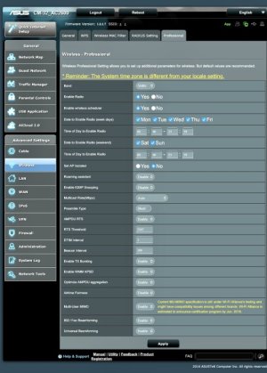

First - there is no custom firmware for your modem/router. Second - the screen shot you posted is with very tiny barely readable text. I don't see very well - are you are disabling the radio for 2h every evening between 22.00h and 0.00h? Disable all MU-MIMO and Beamforming, TX Bursting, WMM APSD, AMPDU Aggregation. Try again. If still no go - reset to defaults, don't change any Wi-Fi settings and try again. If still no go - replace the modem/router.
