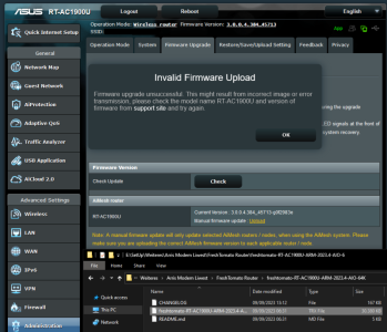

3, in administration settings i went to firmware update and selected the correct file for my specific model
freshtomato-RT-AC1900U-ARM-2023.4-AIO-64K.zip (ofc before firmware update extracted the archive)
i've downloaded this firmware here https://freshtomato.org/downloads/freshtomato-arm/2023/2023.4/K26ARM/
5, FT's instructions show a successful firmware flash as the next step, however not for me - invalid firmware upload, upgrade unsuccessful...
6, i tried it again but the result was the same

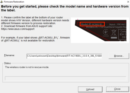

The official asus firmware restoration tool that must be used with rescuemode does not work, after 30 seconds it respons,
"the wirelessrouter is not in resuce mode" BUT IT IS because i can see the led pulsing...

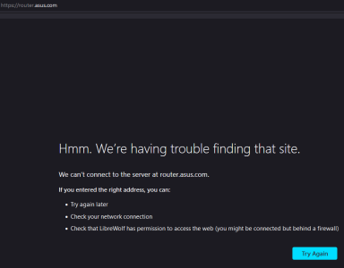

Connecting to 192.168.1.1 loads for few seconds, then returns "unable to connect", i tried it both via ethernet and wan port.
both router.asus.com and 192.168.0.1 fail to load instantly while the 1.1 adress does load but then times out or whatever goes wrong i cant say.

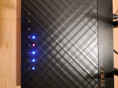

The problem is with the wan-port, the led is red. All other leds are blue.
Resetting the router via reset button or wps button does work, the device reboots and all leds light up for a moment,
then they turn off again and after loading a minute or so the 2.4G and 5G aswell as power led's are constantly blue, but...
the wan led is flickering blue and then turns red.
Atleast 8 times i did the reset, wan led is still red.
What do i do? Is the device hard bricked?

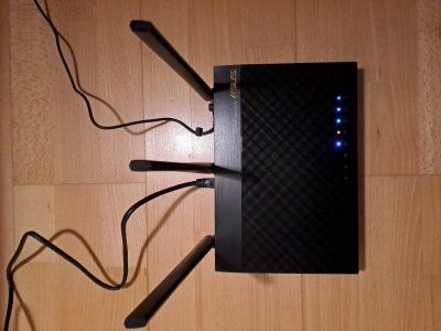

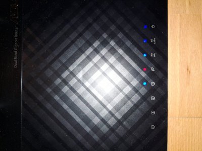

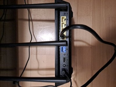

On your pictures - you have nothing connected to the WAN port.
As already suggested, have you connected broadband (or upstream Ethernet) to the router's WAN port? Not having anything connected to the WAN port will typcially cause the WAN indicator to not show blue.
When using the Asus Firmware Restoration tool, and you are having trouble accessing the router. Did you manually change the IP address/subnet mask of the computer you are using to flash the router prior to attempting to use the tool or access the router after recovery firmware flash?
[Wireless Router] How to use Rescue Mode (Firmware Restoration)?
Set the PC's IP address and subnet to the following (per above link):
IP address: 192.168.1.10
Subnet Mask: 255.255.255.0
Also from the above link:
3. Why can't I enter router setting pgae after successfully updating firmware by the Firmware Restoration?
First, please check whether your TCP/IPv4 setting properties is set as [Obtain IP address automatically] & [Obtain DSN server address automatically].
If the problem still occurs after completing the setting, we suggest you that push the RESET button.
If that doesn't work either, please follow the preceding steps to update firmware again by using Firmware Restoration in the Rescue mode.

No i did not prior to flashing change the network adapter settings.
However i did this when trying to use the recovery mode of the router.
I've set the adapter to use,
As i said connection to the router does not work neither via ethernet nor wan while using these settings.
FT's instructions clearly state "NEVER flash firmware over wan", doesn't matter anyway since the connections to the router isn't even established in the first place.
That's not what people were saying. They were saying that the red WAN light was caused by you not having anything connected to the WAN port. Nobody was suggesting that you connect your computer to the WAN port.
