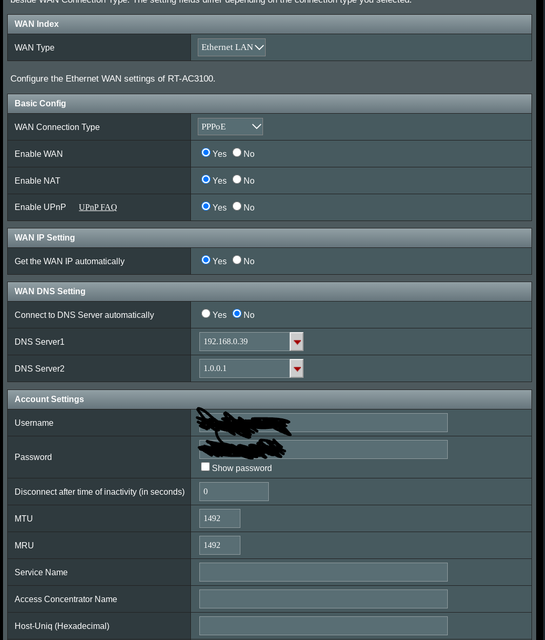

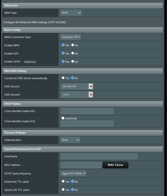

Hello All,
So I am trying to configure my rt-ac3100 (currently on the latest beta firmware) with dual wan set up.
I would like my primary WAN to be Starlink.
I would like my secondary "fallback" WAN to be my DSL ISP.
My Set up is as follows:
Here are what the two configurations look like:
So that is what my configuration looks like. Well it doesn't work. It gets the Starlink at the primary fine but when I pull the cable out of the router I can't get it to fallback to the DSL as the secondary.

Hello All,
