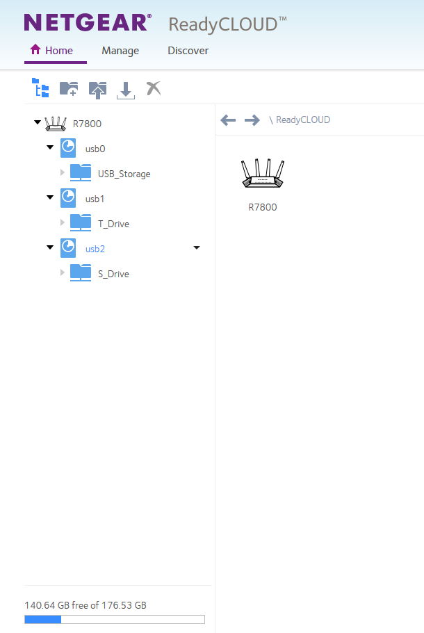

There seems to be a bug in the readyshare portal possibly
I have hooked a two 32gb pendrive but it says 180gb of storage coming no where.
jE6i3F
It looks like you are looking at the drive size information provided by the Netgear Readycloud app which may have a bug in it.
When you look under Readyshare in the web interface (http://www.routerlogin.net) does it report correctly?
I tried two 16GB usb drives and the web interface reports them correctly. I do not use the Readycloud app so I could not check it.
