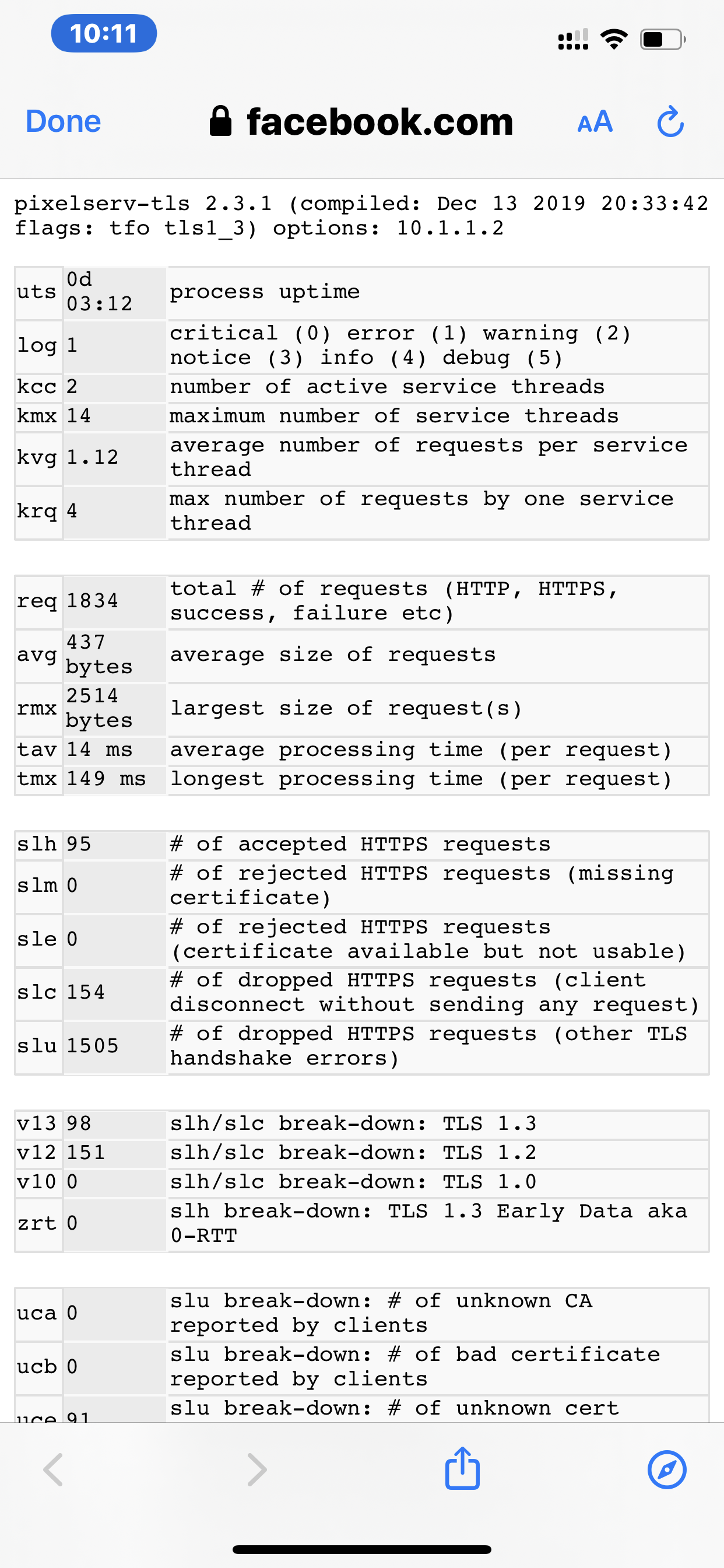

Ahh, okay. Something is wrong then. Here's what I'm seeing now for https://facebook.com/servstats
Refresh the page again and you should see the stats now, Pixelserv-tls needs to generate the certificate on the first visit.
Also you'll only see that page IF you have the Pixelserv-tls Root CA imported and enabled in your mobile device.
Yes, you'll just have to follow the instructions from the "Import Pixelserv CA on client devices" part, no need to generate the Root CA since Diversion already took care of that part.

Here is what I did, I added the ca cert
The I went to https://facebook.com/servstats
and I just got a black screen again.
Then I tried to check picelserv on http://192.168.50.3 and this is what I see:

Did you also enable full trust for Pixelserv?
Settings app > General > About > Certificate Trust Settings > Enable Pixelserv CA

Alright I've just noticed you're using Pixelserv-tls v2.2.1 and that's not compatible with Apple's latest operating system for its devices. Now you have three options:
-Wait for Entware to push the Pixelserv-tls v2.3.1 update.
-Manually update your Pixelserv-tls to v2.3.1 as per kvic's instructions.
-Or use the unofficially official JackYaz Pixelserv-tls v2.3.0 for now. You can update to it by opening Diversion and pressing ep>6>3.

Yeah, I've done that. I get the same result. Thanks for the reply though.
Pixelserv is running on 192.168.50.3 ... the ip range starts on 192.168.50.4 and all settings are correct in the router and pixeserv

Okay, I've updated for now to JackYaz (I'll do the other way later) but unfortunately after deleting the first cert, then installing the JackYaz ca cert on my iPhone, and then enabling full trust for the certificate I'm getting exactly the same result on https://facebook.com/servstats and https://192.168.50.3

Open Diversion
Press ep
Press 3
Press 1
Press 1
After the certificates have been purged, toggle Airplane mode of your iPhone again to clear any cache and then try again.
This time try with this URL as well:
https://192.168.50.3/servstats

Awesome, that did the trick. All working now.
