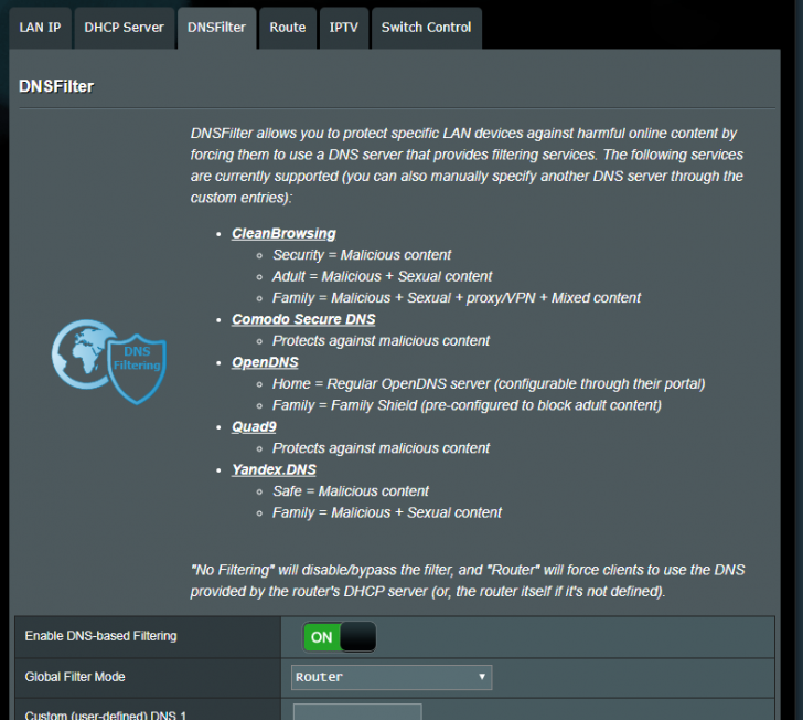

What browser are you watching youtube videos from. Also are you using any custom dns settings in these browsers which might be diverting you away from using diversion?
chrome and Panasonic TV - not that I know of but I was originally using Unbound as the primary DNS for ALL LAN Clients. But not now since I can switch easily between Unbound and dnsmasq-
are you doing this on a device that might use a hard-coded dns or just from your home desktop computers?
If you are doing this from a device that has a hard-coded dns, are you telling DNS filter on your router to force traffic with global mode enabled and set to router?
Yes DNS set to Router as above
