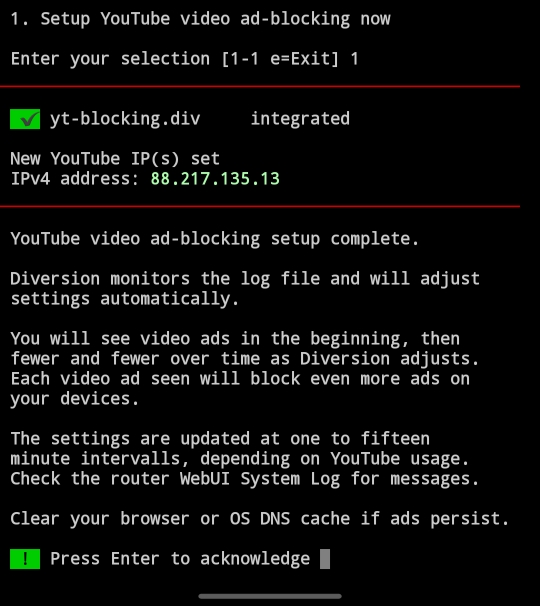

Just a FYI. The YouTube yt_blacklist is updated with the following check interval:
A cron job triggers yt-blocking.div every minute. It will read in the /tmp/div_yt_count file which says where the count is at (use cat /tmp/div_yt_count to see where it's at).
The update code in yt-blocking.div will only run when the couter is at [0-9]|1[0-9]|20|25|30|40|55.
So every minute if the counter is 0-20, then at 25, 30, 40 and 55 counts. At 70 it will get set to 30 to start again from there.
In every case, if at one of these count points a new domain is found, the counter gets set back to 1.

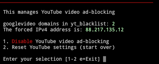

just updated when I enable YT blocking I get "YouTube domain is not valid" :(
That means the picked up *.googlevideo.com domain did not resolve properly and returned an error.
Try to rerun, if it still fails, you may have to reset the dnsmasq.log files in d.

Reset the dnsmasq.log files in d. Watching more videos does not help at the moment.
I still try to figure out how to better handle these errors instead of quitting right away.
Reset ad counters and Dnsmasq log files and rerun. Than browse some youtube videos and saw some ads but still same error. Btw; I've manually search dnsmasq.log for "googlevideo" and I can find domains as below.
Can you do this for me?
First enter this in the terminal:
/opt/bin/grep -a -m 1 "reply.*-.*\.googlevideo.*\..*\..*\..*" /opt/var/log/dnsmasq.log | awk '{print $6}'
It should return one of these googlevideo domains. Post it so I can run it trough the validator.
I got this, you have "log-queries=extra" set in ds settings. Let me figure that out. But first I need to do some other stuff.

Can you run this, it should return a valid domain:
/opt/bin/grep -a -m 1 "reply.*-.*\.googlevideo.*\..*\..*\..*" /opt/var/log/dnsmasq.log | awk '{print $(NF-2)}'

I pushed a silent Diversion update
- Corrects YT domain error when "log-queries=extra" is enabled in the ds settings.
Now we all should be in business with YouTube video ads blocking experimental feature testing.
Thanks for persistently reporting.
Use uu to force update.
that was the trick!!
I disabled extra log queries and succeeded with the activation
thanks @thelonelycoder
Sent from my SM-G970F using Tapatalk
Update Diversion to the above update and you can turn extra logging back on.
wow , that was f*****ing fast
I'll try activating log queries extra and report back ;)
All seems working now. thank you. I've started testing :)

Unfortunately I am still getting ads when watching Peppa Pig on Android. Getting Candy Crush Saga, Pinball, asmr slicing, pokemon go etc ads everytime the Timer on the video hits the small yellow bar. Please note on Desktop this is no problem because I have uBlock Origin installed and the ads don't appear.
I've ran option b and ran through installation again but it still persists.
When setting up Diversion I followed the "
How to use an upstream DNS Server like 8.8.8.8 from Google" So I have no idea if maybe enabling that is causing ads to appear.
