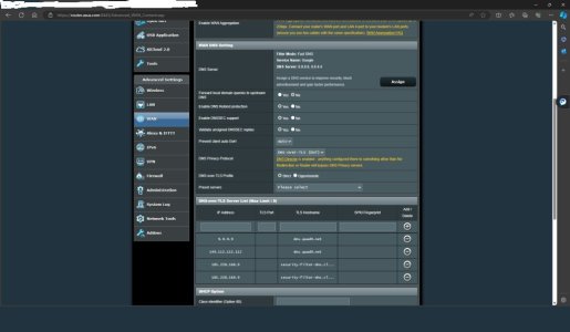

Can you post a screenshot of how you have your DNS settings configured in your router?
