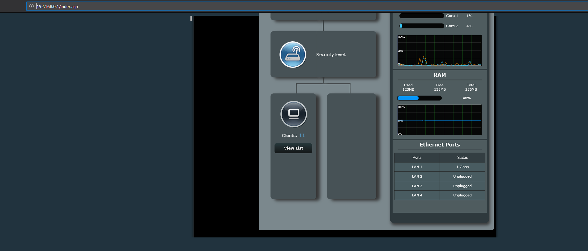

bit of a problem with this one, while all runs fine, i cant access the gui properly once logged in, an example is below:
tried firefox and chrome, no joy.
Thanks for testing, I m checking what's wrong and post a new image once fixed. Stay tuned.
This is generally caused by a Javascript error. Open your browser console, and post the error message.
