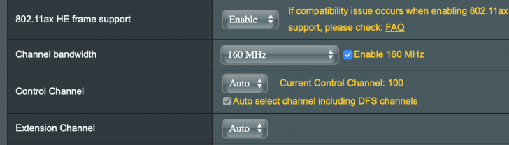

@RMerlin - Would it be possible to remove the "auto" select channel check from the 160 MHz bandwidth and allow that users pick the channel they want?
I am sure I missed this if it was announced on the one of the changelogs but every time you check the "Enable 160 MHz" box, it automatically locks the "Auto select channel...." box. As shown above, my AX88U automatically picks channel 100 but I used to have a lot better response with channel 48 and I cannot change this.

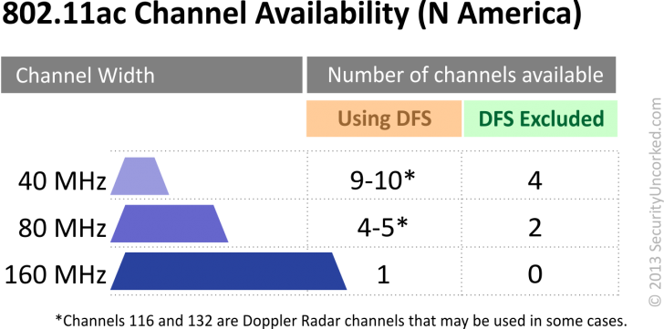

There is nothing to choose...
And even in the US, there is 2 options, but the second one is not permitted (enabled on all routers); where channel 48 is certainly not possible.
Actually I am in US and I remember having a lot more channels to choose from a few FW releases ago. It is possible that these settings changed recently. It is also possible that they are closed source from Asus and so there is not much that you can do about it.
