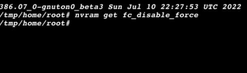

I just switched from my old and trusty RT-AC68P to the RT-AX86U.
FlexQoS is only working properly for me if I disable Flow Cache manually
To do so I added the command
fc disable
to firewall-start in /jffs/scripts
With Flow Cache enabled the router does not properly categorize and limit traffic - it almost behaves as if adaptive QoS is not turned on.
With Flow Cache disabled everything seems to work like on my RT-AC68P - including additional IP Table Entries (lowering priority for my backblaze online backups)...
I believe that this is the same on all ASUS AX routers. It certainly applies to my RT-AX56U and RT-AX68U.

With Flow Cache enabled, I can have some linux distro uploads going, but FlexQOS has no clue how much bandwidth is going through the router. There's ping spikes galore... a few nights ago I got roughly 280 alerts from connmon. I dropped the limits in QOS, but it had no effect, because a lot of data seems to bypass QOS entirely.
Then I checked, reapplied fc disable, and all the symptoms go away. Plus the graph shows properly again and the numbers add up.
That should be a recommended/required step, mentioned while installing. It's frustrating for novices to figure out, and seems to apply to enough router models that it warrants mentioning. Perhaps even automatically enabling it, if speeds are under 100mbit or so.
With fc disable web responsiveness with torrents going has significantly improved.
