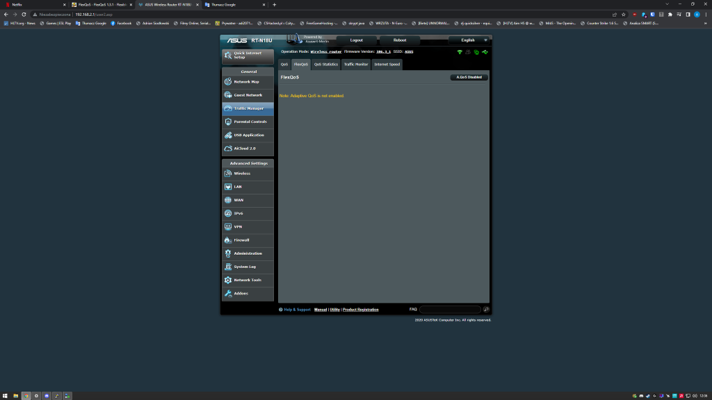

This works similar to adaptive qos with manual bandwidth setting. Please help me with this script. I want to test it and adapt it to my own needs. Unfortunately, I was able to install it, but the menu showed that the adaptive qos is turned off. Need to remove checking.
This script won’t do anything if your router doesn’t have Adaptive QoS. It doesn’t replace Adaptive QoS. It depends on Adaptive QoS and the Trend Micro components.
Until I try, I won't find out. If no one helps me on this forum, I will be sitting on it myself until he finally manages to remove the checking if adaptive qos is turned on.
Unfortunately not. After repairing the code or even removing this part of the script, it still checks if qos adaptive is turned on.
True. That’s just the first of many problems you will encounter as you try to fit this script for a purpose it was never intended.
