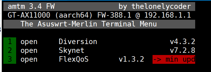

Anyone upgraded to latest FlexQoS update?
Anyone upgraded to latest FlexQoS update?View attachment 46626
