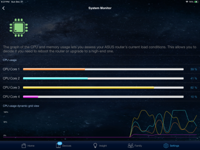

For those who have mentioned no cpu 4 usage… I had my xt8 under decent load streaming 4k and also copying 100gb from a connected USB stick (in the main XT8) to a laptop…
