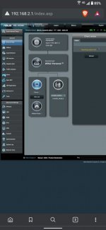

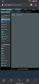

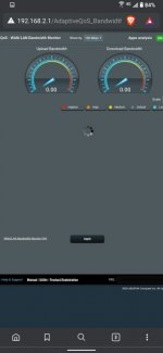

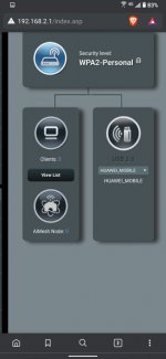

Hi my friend
In the new version 386.02_6 Alpha. Can't find my mobile IP address ،wirelessly, Recognized when I connected with the wire,and not work AiMesh

@Bluesky I have notice that. I had to reset to factory to get the clients count working again.
DO NOT RESET TO FACTORY YET.
A new 386.02_6-gnuton0_alpha2 will be available in about 1 hour. Please try to flash that and let me know how it goes.
386.02_6-gnuton0_alpha2 is now available for testing.
Please let me know if client count in the main page is zero and if AiMesh works.
