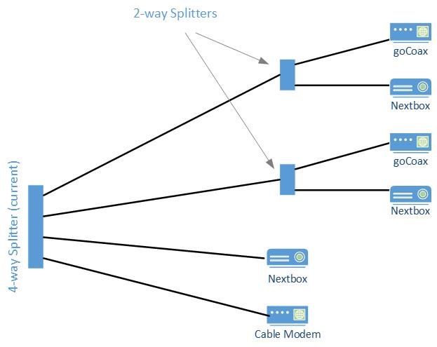

Hmnm.... But the Nextbox are MoCA devices, aren't they. They should not be connected to the MoCA adapter TV port.... they should be off a splitter. In other words, I count the following total MoCA devices: (2) adapters and (3) Nextboxes, plus the Modem. So in total you need a 6-way splitter. Or (2) 2-way splitters, one each connected to your current splitters ports 1 and 2.
I may be wrong but double check the gocoax manuals. Those adapters, the TV port should have low-pass filter which blocks *any* MoCA whether 1.0, 1.1. or 2.x

I prefer to diagram, so I doodled what I meant. Hope it helps further.
I'm not sure what changed to make it stable... i'm just glad it is! That said, I'm not sure if the speeds are great (see pics below).
As for adding two 2-way splitters, do one or both of them need to be MoCA enabled? Unfortunately, my only MoCA enabled splitter is the 4-way currently in use. I do have older non-MoCA splitters I can use, but not sure if that would work. Please confirm.

I added splitters as recommended and now Whole Home PVR is working. The Adapters unfortunately are still intermittent (and down as of this writing).
My config matches the diagram you provided earlier (now updated below with equipment info in case needed). I actually do have a spare moca filter which I'll add between the 4-way splitter and the modem tomorrow. I'll report back once completed.

I do see something that may be an issue. In your latest diagram, you have the Antronix splitter as 5-1002 MHz. From what I know, MOCA 2.5 functions in frequencies above 1100, so that splitter may be blocking some of your signal. Just a quick thought.
I don't have another 2 way MoCA splitter at this time. I did find another 4 way splitter though that may work. Should I incorporate it into my config ? If so, is it just a matter of swapping out the 2 way Antronix or should other changes be made?
