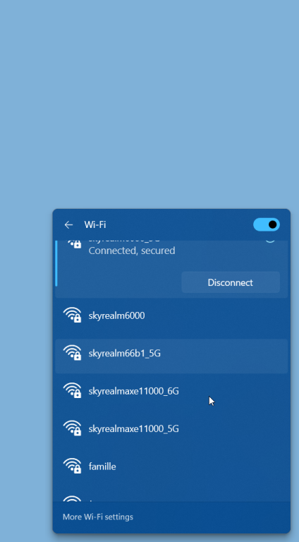

I have noticed on both my phone and laptop the 6E network is not always appearing in the list of networks available. On both I have been able to enter the SSID manually and connect, and from there it has been working without issue. Maybe worth a try, assuming you haven't tried to force the manual connection yet?
What phone do you have? I've got an iPhone 12Pro Max and from what I can tell, it does not have 6E capability. My wife's 2022 model W11 Asus ROG Zephyrus G14 laptop OTOH, sees and connects to the 6E network with no issues other than the very first time when it did not see the 6E network at all. A computer reboot fixed that.
Samsung S22 Ultra, which definitely has wifi 6E. Also a 2022 Zephyrus G14. When I swapped the wifi cars to an AX210 the 6E network was shown in the network list without issue but on the factory mediatek adapter it didn't show.
I have tried a manual connection. The 6GHz signal strength is pretty strong at -46, my S21 Ultra connects at 2401/2401. I started a thread on Intel's Wireless Product Support Community Forums but noticed a similar thread where they basically told that user to pound sand and get with his OEM, so I don't expect a solution from them. Guess I'll have to deal with Dell, since two of the computers have factory installed AX210/AX211 adapters.

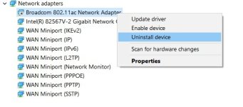

You can try a couple of things:
From Windows "All Settings" > "Network & Internet" you can try:
1) from Network settings scroll to bottom and try "Network reset" This should be the same as above but letting Windows do its own thing. PLUS REBOOT (they've made so many changes that this could work slightly differently / unknown.)
***2) from "Device Manager" uninstall the adapter and reboot and see if it Windows re-installs the adapter on its own. Be prepared to manually install the drivers. If the units can be hardwired during this procedure, keep it connected so Windows can access the internet to get drivers on its own. (( The Dell software may install from its own restore image???))
EDIT: Are you on the newest Bios for the 4 Dell's? If this hasn't been done/upgraded then you should make sure you are on the newest.
