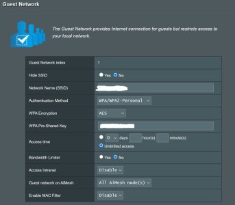

Hi, my setup is an RT-AX88U as the main router, 1 RT-AX86U, and 1 RT-AX86U Pro as nodes, they are all running Asus firmware. After I caught the cameras randomly connecting to Beijing, I set up a guest network for all of my smart devices and security cameras.
I only have 1 guest network but cannot connect to the guest network on any node. I can connect to the guest network on my main router.
I am using guest network 1, I have disabled access to the internet (see attached).
Does anyone have any ideas?
Thank you!

Do a system reboot. Also, currently there is an issue with guest 1 on the AX86U Pro when used as a router. Problem could manifest itself with the unit as an AiMesh node. May also be a good idea to factory reset reset everything and manually configure again.
Thank you; I've tried rebuilding both nodes which didn't work. I'll factory reset everything, start over, and post the results.
I've factory reset and rebuilt everything to no avail - nodes are not transmitting the guest network. Does anyone else have any suggestions? I would open a ticket with support however I've been down that road many times; its always a dead end.
