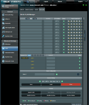

I’m looking for help from users willing to map the physical LAN ports on their router so proper MerVLAN device support can be added upstream.
I’ve created a fully standalone helper script that:
  • Detects the WAN/uplink interface
  • Walks you through mapping each physical LAN port (LAN1, LAN2, …)
  • Generates a ready-to-use hw_probe.sh case snippet
  • Saves a full report under /tmp
  • Provides a pre-filled GitHub issue link for submitting the results
  • Optionally patches a local MerVLAN install with temporary support (until official support is added)

Community added model support:
MODELCONTRIBUTOR
RT-AX86U
GT-AX6000
mistermoonlight1
kstamand
If you know the mapping already you can just fill in a template, example below:
RT-AX86U) MODEL="RT-AX86U"; ETH_PORTS="eth4 eth3 eth2 eth1 eth5"; LAN_PORT_LABELS="LAN1 LAN2 LAN3 LAN4 LAN5"; MAX_ETH_PORTS=5; WAN_IF="eth0" ;;
In this example we map eth4->LAN1, eth3->LAN2, eth2->LAN3, eth1->LAN4 and the eth5 (2.5gb port) to LAN5. We map WAN to eth0 and set the map LAN ports to 5.
