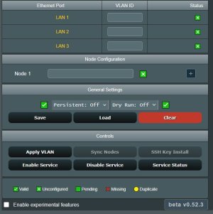

1-With the new dev version v0.52.3, the gui vertical scroll bug is gone forever. Good job!
2-Where at some point i am loosing a lan port in the experiment is probably because i don't use the multiple buttons in the correct order i guess. I am not sure yet if i need to do save 1st, or apply vlan 1st. But in my case, once i removed the tested vlan (just deleting the vlan number in the LAN case) and playing with the save/apply vlans button, it 1st removes the vlan on LAN1 i was just erased myself and few seconds later, boom LAN4 is gone (refreshing the page does not help to make it come back) (see attached picture)
3- On my AP, creating a test vlan on LAN2 makes eth3 going to the created VLAN has expected now. Very good!

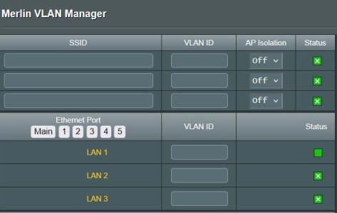

I figured out a simple recipe for loosing LAN4 on my AP: i uninstall full, delete every left trace of mervlan in the file system, than reinstall (using 1st page instruction of this thread which get it from the main branch 1st) and update from the dev branch version v0.52.3. I am back with 4 lans ports.
Now here is just what i am doing:
a) set Dry run: off, persistent: off
b) types 222 in LAN2 case to create this vlan
c) press the "Save" button. Initially after the saving, i am still have 4 lan ports. May be x secs later, a page refresh and now i have just 3 lan ports!
there is nothing special in the logs that gives any clue...

1-i found something more about the LAN4 lost problem. While a web page refresh in the browser (or anything i attempt with the gui or buttons) does not make the LAN4 port coming back, a complete router reboot repairs the problem everytime and the LAN4 port is coming back after a reboot without needing to do anything else!
2- i have also noticed that after the reboot, it took me a lot more effort to loose the LAN4 port again, i had to play a lot with the gui buttons, like push save, delete the vlan, push save again, recreate it, push save multiple times, apply vlan, and at some points i got the bug again. But it was just more easy to get the problem a couple of times by starting from a clean fresh installation (from the main branch according to original instructions), than updating from the dev branch v0.52.3, than starting to play with the vlan immediately in the gui without any reboot of the unit (i got the problem much more easily like this (2 differents full install attempt) than following a reboot today. A coincidence?).

hi @r80xcore
I miss the interim dev v0.52.4 version. Updated today with beta v0.52.5 and i think it made things worst. Now each reboot i have a limited 3 SSID and 3 LAN ports permanently that persist each reboot (without me doing anything on the gui, just rebooting). Immediatly after v0.52.5 update, it was still broken and persist after a reboot now...
I guess i may attempt to get through github the intermediate version v0.52.4 manually just before you started added new features
@r80xcore
Hi!
Good news!
After my experiment with v0.52.5, i manually used the backup you made at some point in the structure of my old v0.52.3 (before the update i guess) and override each files one by one carefully, than after a reboot, i came back at v0.52.3. And now i manually get the 8 files you changed for v0.52.4 and override my current v0.52.3 manually taking care to merge the settings file new changes with my old settings file. And after a reboot, now the web pages is displaying v0.52.4. And this is where the magic begins: with the franken v0.52.4 i recreated manually, no more LAN4 loss bug anymore :) . I can see the difference now between the previous version: when i press the save button (or apply vlan), i cannot remember which, sometimes it took a very long times> 10-20s before a sudden refresh is happening, and that was always at that moment with v0.52.3 that LAN4 would suddenly disappear from the gui.
Suggestion: So i guess v0.52.4 should go to the main branch so there is a way to get it more easily while the new development for v0.52.5 makes some progress and getting better stability... For my setup, v0.52.4 is the best stable version so far
Thanks a lot for all this good work
First i have some questions:
Did you get an "unsupported" popup when reloading in 0.52.5?
The new feature affecting you makes easier to track these kind of bugs from now on. The ui bug should be fixed now and this is probably a profile problem.
You can test this easily. (in 0.52.5)
Run
nano /tmp/var/wwwext/mervlan/settings/settings.json
Scroll down to the hardware section.
First check if it says:
"PRODUCTID": "Unsupported"
Then test to change MAX LAN to something else, like 8.
Press ctrl+x, y, then enter to save.
Then reload the UI and see if this changes the amount of ports.
If so, this is only that the model wasnt loaded and an easy fix.
Also, everytime you update the addon a backup is made. You can access and restore these by either running:
These two commands:
cd /jffs/addons/mervlan/functions
./update_mervlan restore
Or this command:
(sh /jffs/addons/mervlan/functions/update_mervlan.sh restore)
Make sure to include the ( ) if you use the oneliner.
Just follow the instructions and choose one of up to three saved backups.
