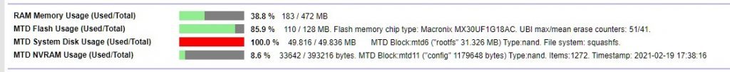

I had a very similar experience with a simultaneous upgrade to FW V1.0.2.82.1SF (Voxel) and Kamoj Add-on:5.4b20. Lost access to my /opt (for Entware). I had to recreate the Entware drive using a new usb stick as the the existing usb is locked “read only” and cannot be reformatted. Also, no partition tools (tried several) can remove the ext4 partition. This usb does not have a physical lock.
Thank you. It is helpful to have validation. I deleted the partition on my USB thumb drive; reformatted in ext4; and reinstalled entware. From now on, I think I will remove the USBs any time I install new firmware.
After creating a new entware USB, and rebooting (without any USBs installed), I noticed that my MTD System Disk Usage is maxed out at 100% (see attached image). I've never seen it this way before. The last screenshot I took (in April 2020) showed it at 19.6% with 9.758 in use.
Any ideas as to what caused this, and how to fix it?

Did you perhaps backup some files on the router itself?
Can you do du -h /overlay and see how big that is?
(on my R7800, it is 11.9 M)
If it does have more, then look at the files and see what you can cleanup. Perhaps entware installed into /overlay/opt ??
(i.e. USB was not mounted correctly when you installed it) ?

I did not back up any files to the router (at least not knowingly).
Yes, my overlay output shows a bit more than yours, 699.5M. ;-)
I have attached it. I see the there is an /entware directory, so I deleted it. I also deleted the file "entware-cortex-a15-3x-initial-generic.tar.gz", and the massive file "swap." As you suggested, they were all created during a busted installation of entware.
After deleting all of this, I reran "du" and the usage is a more reasonable 13.5M. This is still more than yours. Please see the attached output (Output of du overlay2.txt). I would appreciate guidance as to what else to delete.
At some point I deleted these folders:
/overlay/opt/rcagent
/overlay/opt/remote
/overlay/opt/leafp2p
/overlay/opt/xagent
They belong to some netgear stufff that I'm not using.
Can't recall anymore what. (might be ReadyCloud related).
Anyways, if you are not sure, just leave them there.
13.5 MB usage is perfectly fine. And I think it is even compressed before it is stored.

I had problems with wi-fi during a high CPU usage (reported it earlier but I was unable to pinpoint the exact reason for it). Can you check what process causes the high CPU load on your router.
Seems like you are out-of-memory, right?
Then anything can happen. Linux OS may reboot the system at any time to regain memory e.g.
Run top2 and ps2 commands, and see who is the hog. (I expect AdGuard, as you can read about here in this thread).
As a beta-tester the community hope you will examine this and find the culprit, and hopefully solution.
