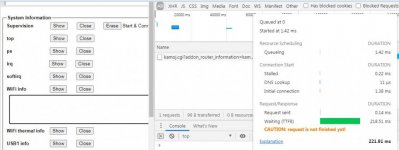

On my R7800 running as router with b22, it still displays blank for WiFi info. I did not reboot as it is my main router.
On my R7800 running as AP with b23, after the patch and a reboot, WiFi info still only comes back with information on the 1st use, but blank with subsequent uses.
The attached screen snippet shows the requests from the Chrome browser, along with the sizes of the responses (697 bytes on first use, 96 bytes on second use).

Yes, I understand. It's like I said in first answer: The web-server times out because there is no response for 3 seconds.
You can time the request and see for yourself:
time wifi_info_ip.sh

It's not possible to change the timeout, unless @Voxel have some new ideas!?
You can try the Settings option: Output WiFi devices info to syslog when loading Router Information page
and then look in the systems log for the result.
But I still don't understand how it can take so long time.
If you have time, please run the contents of wifi_info_ip.sh statement by statement "by hand" to see where it slows down.
Also you can set "bash" debug mode by adding "set -x" in the wifi_info_ip.sh file.
Sorry for it not working for you.
I hope we can fix it with some more help.
This function is one of the oldest in the add-on and it could be better done, but not for now,
and not if we don't understand why.

What timeout do you need to increase? There is for example /etc/config/uhttpd with:
# CGI/Lua timeout, if the called script does not
# write data within the given amount of seconds,
# the server will terminate the request with
# 504 Gateway Timeout response.
option script_timeout 60
There is /www/cgi-bin/uhttpd.sh which runs uhttpd with an option "-t 40" what means:

It seems to be a 3-second timeout imposed by the web browser for some reason. If the CGI script takes longer than 3 seconds to run to completion, then the web browser does not wait for the output to be completely generated. The web browser indicates "CAUTION: request is not finished yet!", as shown in the attached screen snippet.

About the 3 seconds thing:
It seems, as @n1llam1 pointed out, that this error is related to chrome
So the first questions are: is this problem reproductible? (by deliberately wait over 3 seconds if needed). Is it happening only on chrome or all browsers?
@kamoj mentioned that it is old code, so I suspect this problem is very rare (or most users would have experienced it by now).
Yes, this behavior is reproducible. It is happening on IE 11, Firefox as well as on Chrome.
If the kamoj.cgi script is modified to sleep for 2 seconds (or less) before returning the output from the date command, all 3 browsers are able to receive the response, e.g. "Thu Mar 11 12:04:49 GMT 2021"
echo $(sleep 2; date)
If the kamoj.cgi script is modified to sleep for 3 seconds (or more) before returning the output from the date command, then all 3 browsers receive only the response headers, but not the response body. All browsers indicate "No response data available for this request." after 3 seconds has elapsed, with an HTTP status of 200.
echo $(sleep 3; date)
Agreed, it's a curious issue that does not affect the vast majority of users.
Interesting. Thank you for this detailed answer.
Seems to be on the JavaScript side then. After a little research, it appears that it needs to receive something before the 3 seconds. Can you try something like this:
echo "waiting..."; echo $(sleep 3; date)
Interestingly, the browser receives only the text "waiting..." (11 bytes) in the response and not the date information, as the response is cut off at 3.05 seconds.
