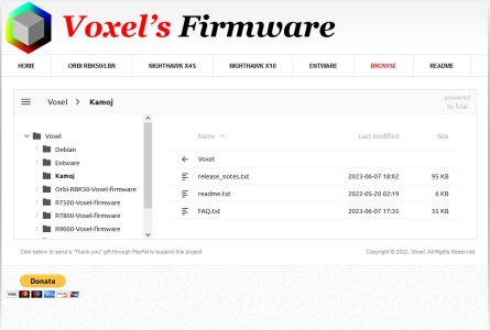

What is the download link for the latest beta for the R9000 installation?
Voxel's site does not list the links! The old version has issues with the R9000 and I'm not sure how to upgrade to the latest beta without the download link.
