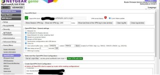

Here is my OpenVPN settings:

Hello,
R. Gerrits, thank you for taking the time to help me look into this. My Netgear Internet setup servers had all three spaces filled with public DNS (ControlID, DNSwatch, Freenom as those seem fastest for me). My R9000 Adguard uses ControlID. I started running AdGuard to test it in the Addon and never turned it off. PiHole runs on a RaspberryPi that is set to bypass the router VPN (and not running its own VPN). It uses a local instance of DNSCrypt-proxy for its DNS. The various public DNSCrypt servers are accessed via DNSCrypt's anonymous relays. PiHole is set to use only the DNSCrypt server and Cloudflared tunnel DOH servers as secondary DNS. I do not have anything listing my isp DNS that I know of unless it is pulled into something like /etc/resolv.conf somehow (but I don't see it there) and I have never seen the isp DNS show up on a leaktest when using the Addon.
I did change the Netgear Internet setup DNS to those of my isp and then I had to leave for a couple hours. I hate to admit it but I forgot to check if the Guest devices had internet or not. Anyway I went ahead modified the ip rules when I got back...
I took your suggestion to place: ip rule add to 1.2.3.4 table $NOVPN_TABLE into the script before
# Bypass VPN for router itself:
I then rebooted the router and checked my Guest wifi access. It worked when setting the Guest network to bypass and not to bypass the VPN! It also worked whether or not the router itself was set to bypass the VPN! I switched my Netgear Internet setup DNS back to the three I had originally used and everything still works. And at least the one VPN leaktest I ran for the router showed only my VPN DNS.

Good day everyone! I'm new here and I just finished installing Kamoj 5.5b17 addon. I even configured my VPN with Surfshark. Are there any documentation for explaining the function of these settings? I'm trying to make sure my configuration settings are optimal for OpenVPN Client, Wireguard Client and or DNS Privacy/Ad-Blocking? Any help would be greatly appreciated. Thanks.
