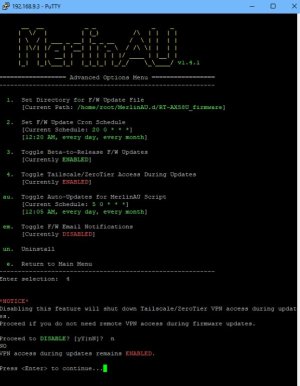

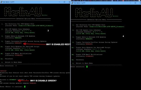

04 - The 5. Toggle seems gramatically incorrect and does not behave in any case, Issue.
Unable to recreate this with a fresh install, did you happen to keep your configuration file when uninstalling?
If so, please delete it and re-test and advise, if not, please provide an example of the configuration file (remember to blank out the password/credentials)

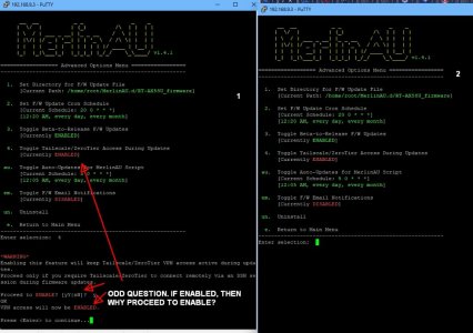

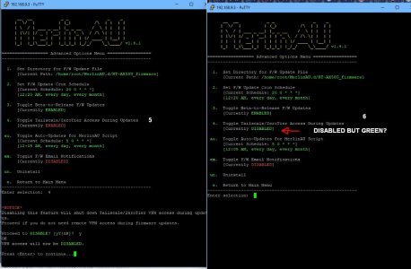

Lol, I was wondering what happened to 4, I thought you snuck in another number and shifted them all one to see if I was awake.... it's on page "ad... "
Apart from an odd initial question, I think it's working but the colours are inverted which is confusing me no end ,,,

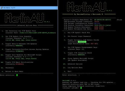

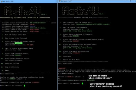

So basically your still having the bug with the changelog check? Is that correct? Could you provide me your configuration file? Just make sure to blank out the credentials please.
As for your question as to why disabled is green and enabled is red, is because green is the default choice for the script for that setting. By default people should have it disabled (green) unless absolutely required in which case the user selects "enabled (red)" which is not the default/ideal choice.

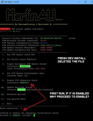

Just testing it again, Seems to behave, apart from the first run question, if it is currently enabled, why is the first question "proceed to enable" and not "proceed to disable?"
OK I see. It is a wee bit counter to the other options so for me a "Default=Disabled" reminder here would go some way to clarifying that :-).

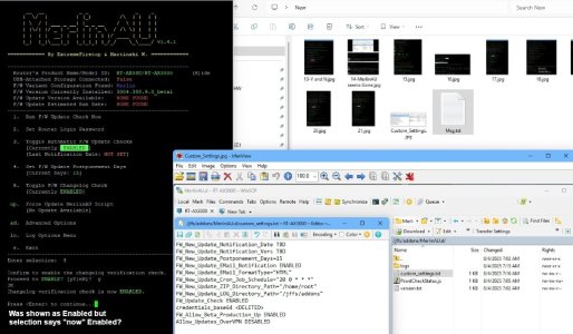

Thats a bug for sure; thats what I'm trying to figure out, with my version from the dev branch with a fresh install it works fine:

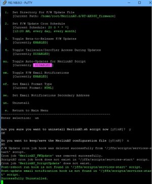

I'm taking a break myself now... I poked for a bit longer; but I can't replicate the issue with the configuration file anymore since my PRs, I'm getting a bit of headache so I'll step away for a bit and wait too see if Martinski has any more ideas or feedback.
To clarify my last reply above, the reason I continued poking if you are on 1.4.1 and deleted the configuration file between tests is simply because it's easy to miss, and as I mentioned in my reply; I did have the problem with the configuration file, and no longer have it on my side since my latest PRs.
Even when downgrading back to the current 1.4.0 I have the issue again. This to me quickly confirms I'm on the right track; but you seem to still have issue.
My only answer right now is the configuration file remained as a bug or user error, or I'm completely barking up the wrong tree and my results are just a red herring distracting from something else.
For example, the uninstall specifically requires a "Y" and then a "N" selection to delete the confirmation file... However if your expecting a "Yes" to confirm uninstalling and then a "Yes" to confirm "trashing" the configuration file you will be caught off guard when that's not how it functions.. it's "Yes" to uninstall and "No" to preserving the file which could be an easy miss for example. Another example is you mentioned you weren't sure where the file was which means a visual confirmation may not have been done that the file is indeed missing between tests (even if you may have selected to delete the file, it could have remained as a bug for example).
It's not to be annoying that I circle back to these points, it's only to verify the information collected is complete, and understood correctly on both sides.

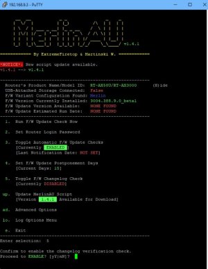

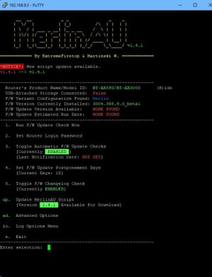

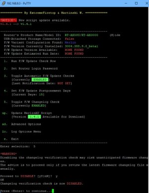

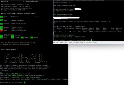

Hi again,
First off I have to apologise for being a bit short last night, I re-read the sequence of my responses and I came across as increasingly snarky, which was uncalled for, especially given you were just trying to help out. It was late and I was tired and was juggling a few things but that is no excuse; it was rude and for that I sincerely apologise.
You may be right about the Y, N sequence, in my hurry I may have inadvertently selected 'Y', 'Y'.
So, I went through the sequence again, this time pausing to check keystrokes between my entries. I have attached some screenshots which hopefully show the required 'Y', 'N' sequence for a complete uninstall and deletion of the settings file. The absence of a custom_settings.txt file in MerlinAU.d, indeed the absence of a MerlinAU.d dir at all, in jffs/addons/ both suggests it is definitely gone.
Totally understood, your tenacity is admirable :-).
I am still seeing some 'TBD' in the custom_settings.txt (although I think they are expected?), one of them I think is because I do not have an external drive (USB) attached (although I did enable DC in amtm, for future use). The others are items that MerlinAU does on a schedule, that have simply not run yet?
I think I am still seeing an oddity with the wording of a couple of these i.e.
  1. ['ad', 4 togggle Tailscale/ZerTier]; whereby it shows (first run), the item being Enabled in the menu, but if I say "N" to enable, it says it REMAINS disabled (which it never was in the first place?)
  2. [main menu, 5, Toggle Changelog]; whereby it shows (first run), the item being enabled in the menu, but when you select enable it says it is "now" enabled? Semantics? For this one, after I changed it via y, 'enabled' (even though it was already shown as enabled?) the changelog verification check I saw the last two lines added in custom_settings.txt:
Awesome! With this confirmation and with these screenshots I have the *confidence* to say my results are likely a red herring; and I can move on and bark up other areas of the code.
I appreciate you taking the time to help clarify these points for me so we have a proper understanding of your issue and testing preformed.
This is great; it gives me a good sense of the state of things after a clean install in your configuration file, which very clearly shows the issue is still there for you.
As you identified, the TBD values in the configuration file is expected, I am not so concerned with the TBD as much as the missing values all together; for example this is my fresh install:

You'll notice when comparing to yours in your screenshot; it is missing many values and appears to stop following mine above at around this line:
FW_New_Update_LOG_Preferred_Path=
This may be a clue; I have a gut feeling what might be happening here... I'll have to test again and discuss with Martinski.
FW_New_Update_Notification_Date TBD
FW_New_Update_Notification_Vers TBD
FW_New_Update_Postponement_Days=15
FW_New_Update_EMail_Notification ENABLED
FW_New_Update_EMail_FormatType="HTML"
FW_New_Update_Cron_Job_Schedule="20 0 * * *"
FW_New_Update_ZIP_Directory_Path="/home/root"
FW_New_Update_LOG_Directory_Path="/jffs/addons"
FW_Update_Check ENABLED
credentials_base64 <DELETED>
FW_Allow_Beta_Production_Up ENABLED
Allow_Updates_OverVPN DISABLED
CheckChangeLog ENABLED
FW_New_Update_Changelog_Approval="TBD"
I am not sure if this helps you at all as I have gone through the menus testing things in a somewhat haphazard fashion, but if you would like me to run a specific sequence to narrow it down, that you can replicate e.g. uninstall > install dev via curl > toggle menu in a very specific order > screencaps, let me know and I will see what I can do to help you replicate it (if you do see these as bugs).
This was definitely helpful; I took a dinner and a nap and headache is gone so I'm ready to poke at this again with some fresh eyes, give me a bit of time to review with fresh eyes and hopefully I'll have found something shortly.
Thanks again for the amazing addon and your support of it!
No thank you for reporting these issues, frankly we need users to report these abnormities; since as you can see even when testing not everything is black and white, sometimes issues are a little harder to track down if they can't be replicated.
(This issue I've tried on both my test devices to replicate for example)
All good stuff, thanks @ExtremeFiretop. Let's see where it goes after you follow it through, there's no hurry on this at all btw.
