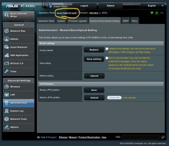

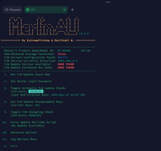

What is the trick to get the webUI to show up? Switched to develop branch but no webUI.
Screenshots please of the update process when you tried
Are you checking under the addon-ons section? Or the "Administration" section beside the regular "Firmware Upgrade" tab?
Were you already on MerlinAU 1.3.10 before attempting to switch to the development branch ? Or were you on version 1.3.9 ?
Version 1.3.10 is a prerequisite of the upgrade process working for 1.4.0
Upgraded from 1.3.10 to 1.4.0 using the force update before grabbing the develop version. Could it be that it’s because I’m running in AP mode?
Probably. I don't think there's much distinction between AiMesh and AP mode in the nvram values we are using.
We can confirm by having you do a: nvram get sw_mode
If it returns as: 0 then that means it's basically thinking it's the same as an AiMesh node.
Which doesn't have a WebUI and shouldn't try to mount the page.
If it returns as 1; then it thinks it's in router mode.
