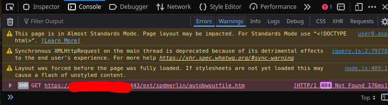

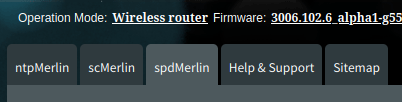

When you run the shell script, what does the CLI menu show as the WebUI URL?New problem. This test version of spdMerlin disappears from the Web GUI. I can still access it through the CLI but nothing through the GUI.
*edit* Further testing shows the GUI page available after a reboot. I'll keep testing until it disappears again, see if I can get a handle on this.
It took a while and a few reboots but it finally happened againIf you happen to run into the same issue again, take a screenshot of the SSH CLI menu (like the one shown above).
As requested:
Magically, if I browse to the user8.asp spdMerlin opens normally and the tab is back. Screwy.
This one is another odd, intermittent event. I'll try to take a look when I get some free time during the week; otherwise, until the weekend.One other thing I've seen is after roughly every third reboot automatic speedtests for VPNs is disabled, but still enabled for WAN.
