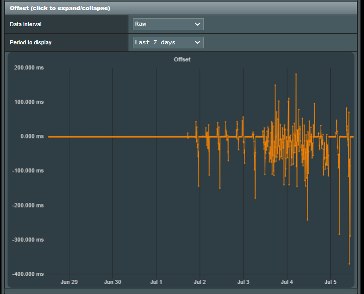

Just noticed a new issue with chronyc. Not sure if this is a sign of degraded crystal oscillator or something else.
Jul  5 02:08:08 RT-AC86U-DBA8 chronyd[2069365]: Selected source 17.253.82.125 (sgsin3-ntp-001.aaplimg.com)

I have this too.
chronyd[4658]: Can't synchronise: no majority
I am on RT-AX86U though with 386.7 firmware
