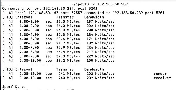

I just did an iPerf test with my MacBook Pro connected to the router via ethernet and running as server. I then used my wife's M1 MacBook Air to run the client. I hope I did this test right as I've never used iPerf before. Here are the results:

That does look slow, even for an "upload" speed test, hmm (unless that's an older Macbook Air). Try a "download" test, E.g. same test in the reverse direction by adding '-R' to the end of the iperf3 command run on the Macbook Air. In general, it might be best to run your slowest/oldest device (E.g. Macbook Air) as the server connected via 1GbE, and your fastest/newest AX devices as the WiFi clients (Macbook Pro, iPad Air 4), etc. BTW, I see a few iperf3 apps in the iOS app store, for $1.99 USD. If you eventually try running iperf3 directly on the AX86U (as server), then you can run iperf3 tests all day long and not eat into your ISP data cap!

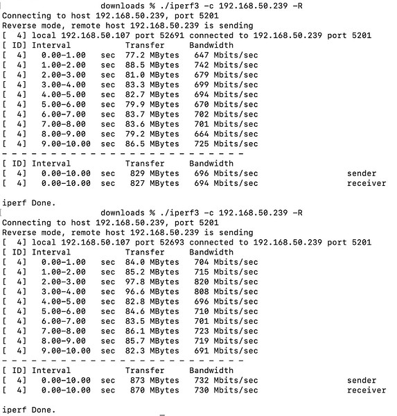

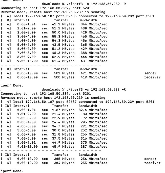

Thanks again for your help here. I just ran another test with the -R switch and these numbers look better. However, there was the occasional slower performance (such as the second test below). Now I don't know what to think. LOL.
Well, some variability over WiFi is to be expected (although yours are going btwn 200-800, which is very wide), unless you have a very dedicated RF testbed for such things (like @thiggins might have). Those are excellent WiFi speeds, at the upper end, perhaps try a few more runs in different positions to convince yourself things are ok. The upload deficit might be do to a power limitation on the TX device, I.e. the Apple device. But, those RX/TX speeds should easily cover your 300/30 ISP plan, so I'm not really sure why you get such low/inconsistent Ookla speedtest.net results. Maybe try https://fast.com/?
