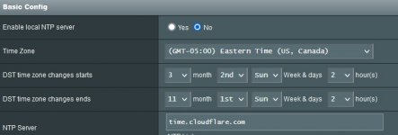

PS: I did note on this merlin 386.3 Beta3 the default DST for Eastern America had an incorrect ending date. Was month of October, I manually changed it to 1st week in November. My setup now as per pic.
