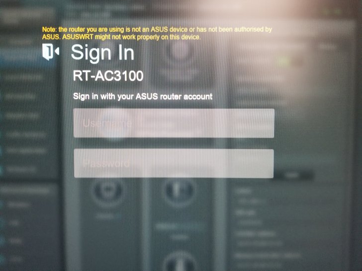

I wasn't able to login to my router (RT-AC3100), I couldn't click on the username or password form. I was receiving an error:
"Note: the router you are using is not an ASUS device or has not been authorized by ASUS. ASUSWRT might not work properly on this device." I had to hard reset. Has anyone seen this before?!
You are using the FW version is RT-AC3100_9.0.0.4_382_18943-g5cf14d5. is't correct ?
