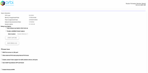

2) My CPU usage on the RBR50 is constantly hovering around 85%, the RBS20 is 20%, and the RBS50 is about 50%. This seems abnormally high?
Seems abnormally high. You should check what process eats your CPU. From telnet/ssh, command 'top' shows processes and CPU load by them.
Voxel.
This is what I'm seeing
Screen Shot 2021-02-11 at 10.36.07 AM.pngScreen Shot 2021-02-11 at 10.36.19 AM.png
As far as I understand you published above two screenshots. First is debug page, second is result of 'top'. Your 'top' screenshot says that 83.2% of CPU time is idle...
Voxel.
Yes, top definitely shows that most of the CPU is idle, even when the debug page shows the opposite. I guess the top command is probably a lot more reliable.
Here's top showing higher CPU usage (but still a lot lower than that GUI)
Error in the web page? Screenshots not taken at the same time?
Both screenshots taken at the same time
You know, my build is more... how to say... more fast to respond. WebGUI itself takes CPU time. Very short time. Few seconds or so. Example: I enter to ORBI's WebGUI, my CPU load:
Few seconds since my entering:
And... Just my build is more fast to catch this peak of CPU load. When you load the debug page. Because of you use WebGUI. I hope I do not outrage NG/DNI.
When you enter to WebGUI it starts to scan anew your devices attached to ORBI, to perform additional actions etc.
Voxel.
Ahh got it! That makes a lot of sense in regards to the CPU load. I had a hunch the gui was putting a load on the CPU... thanks for looking into this though and thanks for a great firmware.
