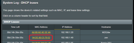

Yeah, so I believe it creates a virtual MAC address which then gets assigned a new IP. That reports as static as if something other than the router is setting it. I have tried assigning that virtual MAC a different IP based on the router DHCP but it seemed to not get taken as if something else had priority. That is not the case when connecting directly to the router via Wifi, I have full control over setting a Manual IP with the Router's DHCP server.
I would start by rebooting the router and then the extender. When everything connects back up I'd check the IP and MAC addresses again.
See if your PC's Ethernet MAC address is showing up on the Asus or whether it's changed (and if so, to what).
Is the extender perhaps bridged to the PC? In that case you might have to make a reservation for the mac-address of the extender.
