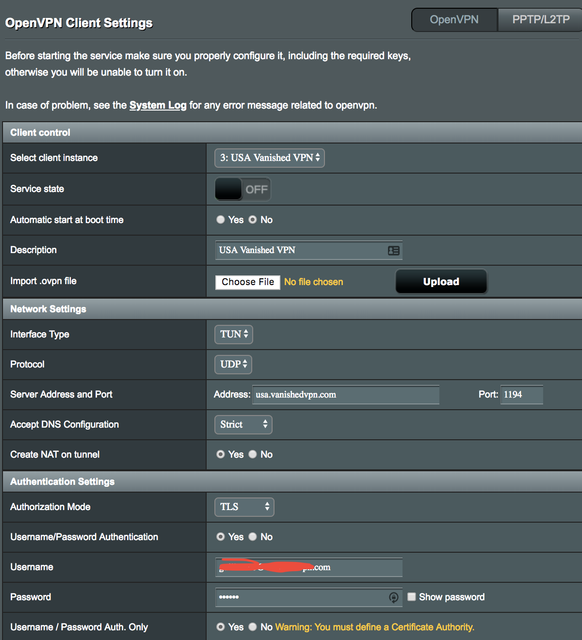

I have issues when connecting to the internet using a VPN.
My provider, Vanished VPN (https://www.vanishedvpn.com.au) provided me with a .ovpn file that I loaded as one of my VPN clients (client 3 as you can see in the screenshots below).
Everything works fine and the VPN seems to connect. That being said, I can't seem to connect to the internet.
I've researched here and tried a lot of things but no luck. Help!

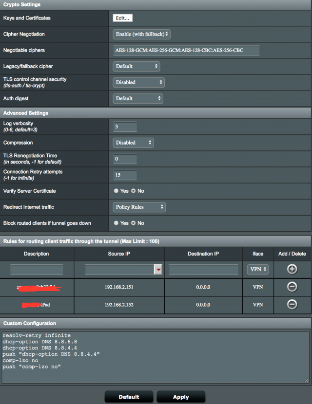

- I tried playing with DNS (dhcp-option DNS 8.8.8.8) and compression (comp-lzo no and push "comp-lzo no") but no luck
- in the service state line, once I turn the VPN 'ON' I get: Connected (Local: 10.137.54.206 - Public: unknown).
- in the custom config part, there used to be only the first line (resolv-retry infinite). The lines after that were added by me as a result of my googling of an answer and my experimentation

Maybe try TLS control channel security : Outgoing Auth(1)
any warnings in syslog when connecting?

OK, no go. I tried with Outgoing Auth(1) and the same custom configuration as you, and also with my configuration.
Ok what happens in syslog when connecting? Maybe increase Verbosity to 5 get more info if needed

I had the same problem with express vpn, no public IP address. I noticed on mine that the compression had been disabled, when I changed it to LZO auto my public IP address reappeared. Having said that something has changed again with the recent .ovpn from express vpn as it now works when the compression is disabled
Try with DNS mode set to "Exclusive". Leave the other settings to what the ovpn file sets them - I assume their config file is correct.
Following a recent security issue found with OpenVPN compression, some providers have started disabling it on their end, requiring clients to also update their configuration.
Also be sure to check that you downloaded an OVPN file that is designed to run on the router. I know that some VPN providers offer files for different OS.
Another thing to check is be sure that you are not exceeding the number of instances of VPN clients that you subscribed for. If you are running a client on on phone and you only paid for a single instance then you won't be able to start a second client on your router.
Also...do you have an active VPN server on the router using port 1194?
OK I figured it out by playing with settings.
What changed from those screenshots:
Accept DNS configuration: disabled
Compression: None
Custom config:
comp-lzo no
push "comp-lzo no"
I still don't get a public address but I can connect and reach pages OK. "Where's my IP" gives me the correct country.
Thanks guys
