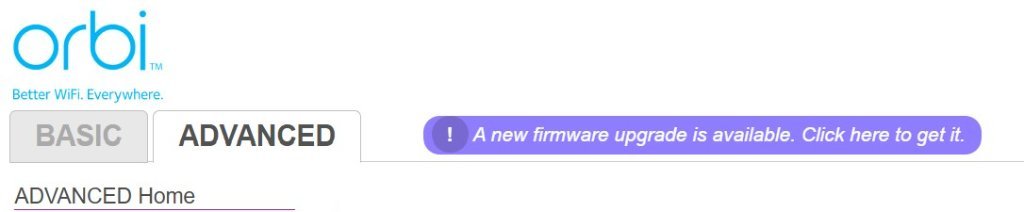

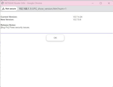

Hey All;
Anybody else see this - Pics below? Logged into my RBR50 today and noticed there is a new firmware for the RBR50v1/RBS50v1/RBR50v2/RBS50v2. I went to the NetGear website, but this new version (Release date of - 01/16/2025) isn't published there. It can only be updated via a direct device update and appears to be the final firmware version for these devices from NetGear.
Any chance someone can get a hold of the new 2.7.5.6 RBS50v2, apply the fix and post? :)
Thanks.
hey @MR2MK1SC,
not seeing a 2.7.5.6 asset on netgear's CDN either, FWIW.
the highlighted part of your screencap appears to contain links. would you share the full target urls of those links with the group please?

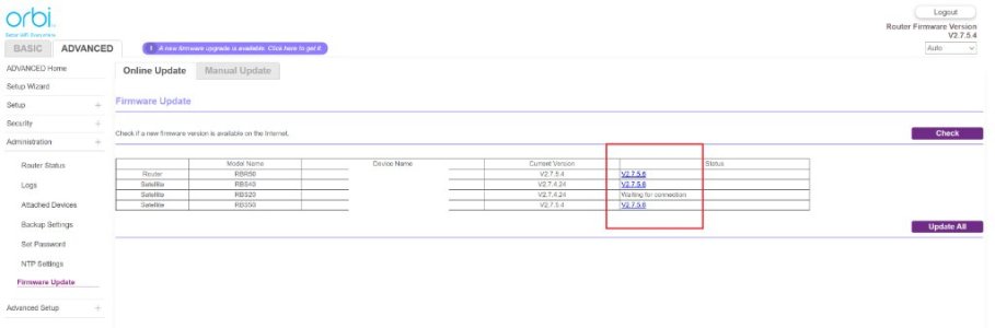

All the links do is show you the following information - See pic.
There is no link to the firmware files. I guess you'd have to click the Update All button, but then my RBS50v2 (converted from a RBR50v2 using the modified firmware in this post) would get the official RBS50v2 firmware, which might brick it.
Thoughts?
