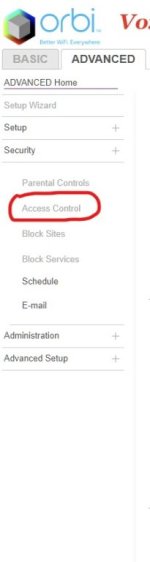

I uploaded Voxel firmware on my other devices too, but I lost the Access Control feature, is it normal or did I do something wrong ? (I use Orbi in Access Point Mode)
Thank you for your help.
That's strange, it works fine for me, Perhaps it's the Access Point mode?
Thank you for your answer.
Yes it might be because of the Access Point mode, but with Netgear firmware this was available in Access Point mode. I might have done something wrong, I don't know what, that's why I was asking, but it's not really important I can live without it :)
Netgear says that Access Control is one of the features not present when the router is in Access Point (AP) mode.
https://kb.netgear.com/000061277/Disabled-Features-on-the-Orbi-when-set-to-AP-Mode
