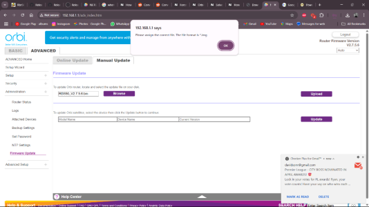

I'm not sure about the process again, I've downloaded your file which is a bin file but to upload it manually via the web interface I think it needs to be an image file or have I missed something again.
Sorry if I'm being stupid
This is what I get when I try to upload it, sorry.

No problem,I renamed the file to *.img; it's on github .Note that this is the same file, just with another name (you can rename it yourself, or download the renamed one).
Sorry, I've been doing the updates most of the time with tftp, not through the GUI; otherwise I would have noticed this myself.
Big Thank You Tonot1, everything worked and I now have another satellite working again, many thanks for looking in on the forum again.

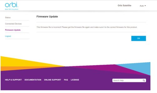

Just tried the update via the GUI on an RBS50v2 running the previous mod'ed 2.7.5.4 firmware and got the following...
Any ideas?
Any ideas?
When doing my initial "testing and delivery of the hackedf firmware", I just used the new firmware-versions and updated them by GUI, BUT the device was still a ROUTER (not hacked)...
Okay, did some limited checking...
The impression I'm getting from these limited tests is that the "hacked firmware" cannot be updated by whatever firmware (hacked or original) through the GUI.... I may be wrong, but that's the first thing I noticed. I did my first tests with an RBR50 with an older hacked firmware and tried what youy did: it did not work...
I then tried ithe same with an older hacked firmware and got the some result.
To me that indicates that the hacked fiermware cannot be updated through GUI.
But, you can update through the TFTP-process. This involves to setupp a computer in your network with static IP-ddress and a TFTP-server, then either:
1) reboot you RBK50 (to become a satellite by this process) and rapidly try to put the new hacked firmware towards the 192.168.1.1 address of your RBK50 (ethernet cable in WAN-port!!)
2) get a serial connection with that RBK50, hold the reset, waiting for "FACTORY MODE".... AND KEEP the reset pushed.... after 5 seconds or so, the RBK50 will then switch and await a TFTP-put (similar as above).
The second option requires connecting 3 pins in the ORBI to a serial converter to USB, but is much more reliable then the first one.
There is also a third option that you can try, based on nr 2, but wiothout need to apply a serial connector:
3) execute nr 2 but KEEP pressing the reset button for at least a entire minute... This will give the same result as nr 2, but without any visual indication. Please note that pressing the reset button an incorrect time MAY cause problems when factory resetting (pressing reset more than 30 seconds, but not more than 34 seconds) Voxel firmware.
The Voxel firmware EXPLICITLY tells you not to factory reset the device. Pressing reset between 30 to 35 seconds may invoke a factory reset.
Maybe I'll do some more investigating, but that may take more than a couple of hours. For now, I'll await any response from you or others before diving into thsi any further.
I've done some more testing....
Updates via GUI will ONLY be accepted when the firmware is actually for an RBS50... Hacked RBS50 firmware is always identified as an RBR50 (done deliberately), so ti will NOT pass the firmware check.
This applies to both Netgear as Voxel firmware.....
Sorry, once you "tricked" your RBR50 into an RBS50, you cannot upgrade to other firmware via GUI, BUT TFTP WILL work....
And YES, all of your settings will remain intact when doing an upgrade via TFTP
