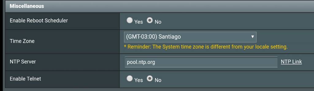

@RMerlinI have found so far (I didn't have enough time yet to test it) that I cannot set timezone... if I put Buenos Aires for example, after applying it, it switches back to Santiago...

Did you try to change the ntp server and the DST time zone? I had that problem and solved it this way!
How do you change DST?
I tried changing the server to ar.pool.ntp.org, but keeps switching back to Santiago if I select Buenos Aires...
