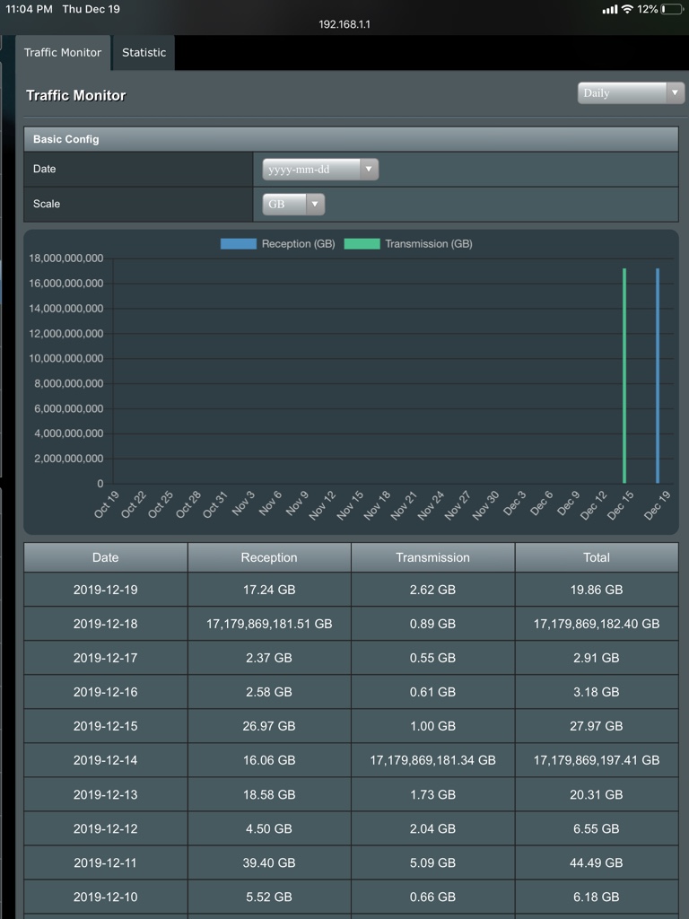

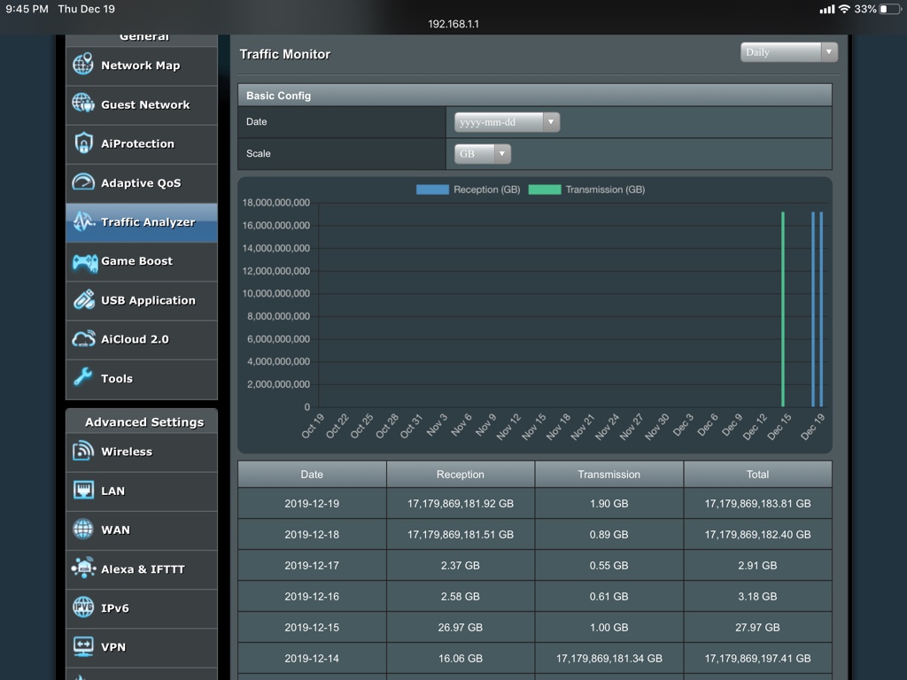

There’s something wrong with the traffic analyzer in 384.14. The real-time and monthly traffic seems okay, but the daily and last 24 is giving extremely wrong results. I’m talking traffic values of 17,000,000,000 GB. This started after I updated to 384.14 on my AC88U.
Edit:
Today’s value somehow fixed itself, but something is still wrong.

There’s something wrong with the traffic analyzer in 384.14. The real-time and monthly traffic seems okay, but the daily and last 24 is giving extremely wrong results. I’m talking traffic values of 17,000,000,000 GB. This started after I updated to 384.14.
Edit:
Seeing the same thing here. .13 fine... .14 showing this problem.
This and the "Internet Status: disconnected" problem (status says that but connectivity is fine) are the two nasty problems I've seen and continue to see with .14 on my AC68U.
