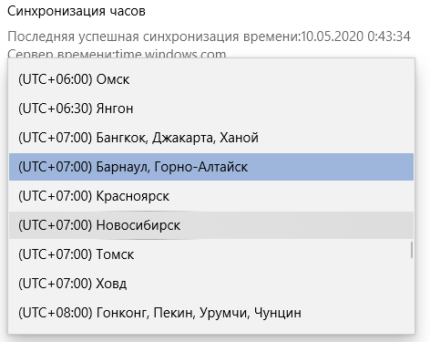

Please correct time zones.
For example, Novosibirsk has the wrong time zone.

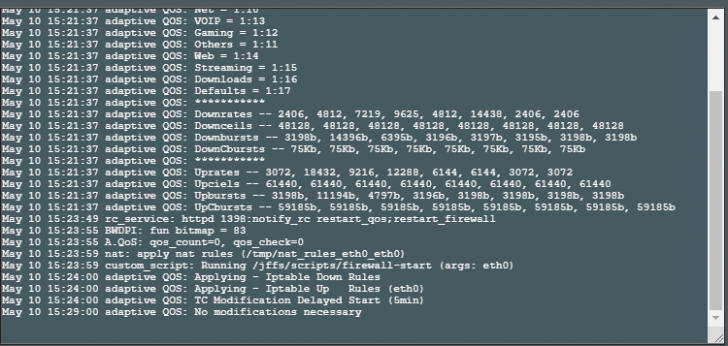

reporting from ax56u with this build 384.17 my qos seems not working, I cant set adaptive manual bandwidth. ex: I set it to 10/10 but when I go for speedtest it went to the max bw as possible causin buffer bloat on the network.
second problem I've found is classification tab under qos isn't working all the number shows "0"
and I cant use freshjr script it when I set the manual bandwidth it shows "no modification necessary" in the log

Hello Merlin
now I'm tryin to downgrade my firmware
thanks in advance
View attachment 23383 View attachment 23384
Downgrading won't help you. This has been reported multiple times alread. Any fix related to the Trend Micro engine will have to come from Asus - stock firmware has the same issue.
