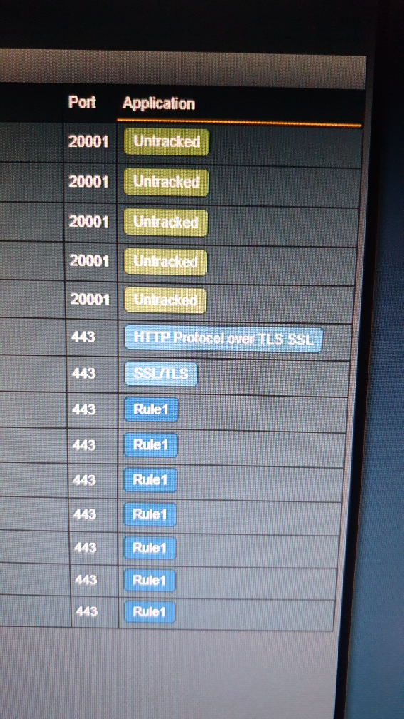

I just found out that sometiomes it goes under untracked and sometimes it goes under game transferring ??
And also the port chaged sometimes ?

On which category goes Gametransfer(Gaming?). The problem is, that i think i have a few webside based untracked data, i dont know ecactly.
How do i know when there is untracked what it is exactly.

The problem ist that if i add manually a rule for a spezific port, the next game with different server has already an other port and the problem happens again.

If yes, then there is the problem that either the game data or an other data is on the first category because on some normal matchmaking cs go games it is tracked right, but as i use a client like esportal (havent tested it with faceit) the game data is either in the category untracked, or game transfer.

With the game IP applied into that field it should track your CS:GO traffic better. Actually I've never seen it end up an issue like you're having with CS:GO only with UT4, it's always been in the appropriate "gaming" classification. Even without FreshJR.
But what is if the game data goes into the category game transfer? Which classification is this?
Because one time i looked on the traffic classifiction and on game transfer there was 80 pps and on all the other casses there was nothing?

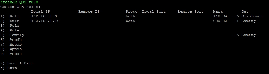

I have setup a Rule for a Specific IP with a specific Mark to be set as File Downloads, but instead traffic is being classified as Web Surfing...
Before was working fine, but after a router reload classification seems not applying my rule.
Any idea?
got a screenshot of your setup?

Yes, here:
So all traffic regarding 192.168.1.3 should be Downloads? That right? Can you show us "live" traffic screenshot from GUI? Can use the dropdown to show only that client.
No, if you see I only set a Mark to it (1400BA), to specify which type of traffic should be set to "File Downloads", not the rest.
Anyway after a disabling qos, reboot, enabling qos, reboot suddenly started working correct [emoji2369]

But you put in a local IP as well.......which if I understand the script right your telling QOS that everything from that IP should go into Downloads. o_O
Glad its working for you though.
That should not be the idea if I put the Mark about which specific traffic I want to be considered downloads, not all the traffic from it.
If you see, only that specific traffic is under that rule, the rest is assigned to their correspondent categories.
