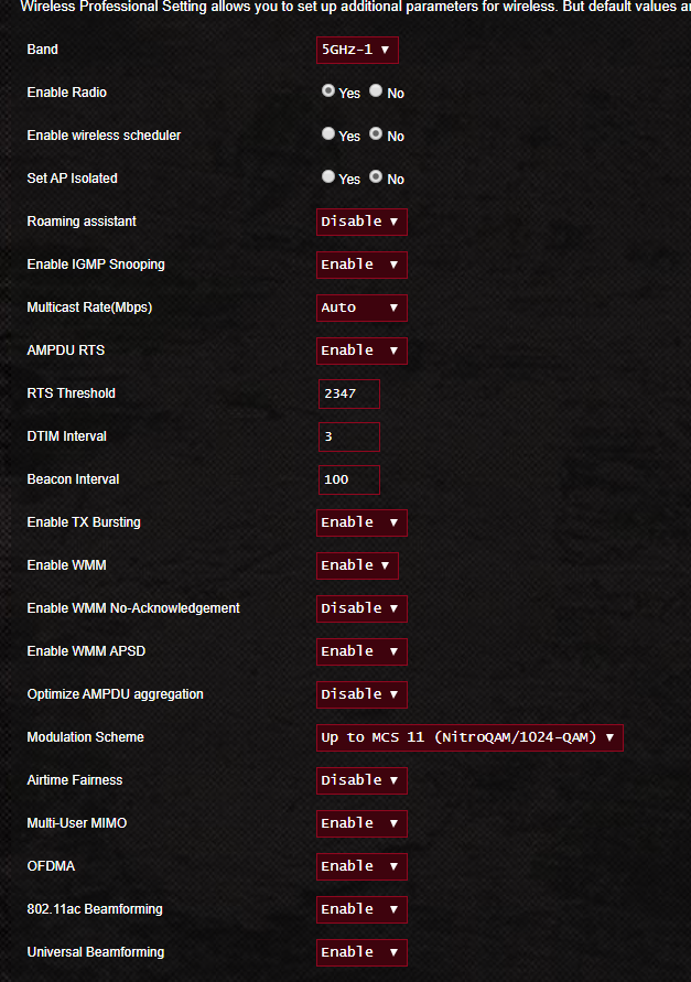

Dlm isn't always the enemy either, it can screw you if the line profile gets stuck, but generally dlm will only slow you down if the line loses sync a lot and has a lot of CRC errors or frequent disconnects in the space of a few minutes . Once every 24 hours or so/ 30 minute cycle won't count in terms of dlm if powering equipment down.
It works like a charm with your settings. Thanks you so much to share them ;)
Thank you for posting, I notice you have Hide SSID set as No for 5GHz-2 (AiMesh), as I walk around my house with three nodes does it auto connect to those or do I have to connect to that Aimesh 5-2? I thought I just connect to 5GHz-1's SSID and it would auto route around.
It will auto connect to the 5ghz-2 band if you manually connect once to it as it's a separate ssid if you want to.
I have 90% of devices connected to 5ghz-1 and a few that I want to have full available bandwidth on 5ghz-2. All roams between nodes happily
I don't use smart connect, so don't know if that works any different.

Can someone please answer this as I can't get my head around it!
If I have 2.4/5-1 SSID not hidden but my 5GHz-2 set as hide SSID (only want the one showing) does AiMesh still work?
